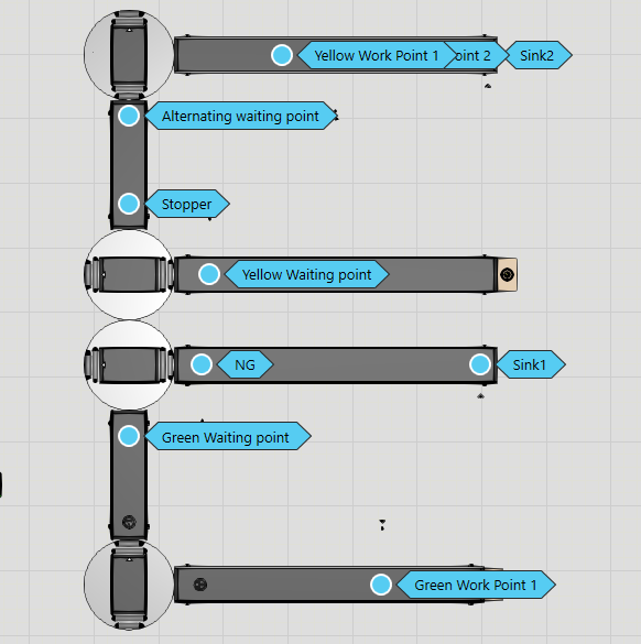

I am a software novice and have encountered many problems while using it recently. First of all, thank you for your patient answers. I am truly grateful to you all.
In a test case I created myself, I tried many times but did not achieve satisfactory results.
I want different products to be transported in the way I have set during the transportation process:

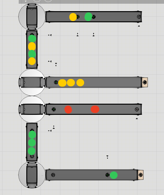

1):After the green products finish working at the green work point, they arrive at the green waiting point, while the yellow products directly arrive at the yellow waiting point. They will queue up at their respective waiting points and then arrive at the alternating waiting point in a green yellow alternating pattern (note: green comes first). If there are no products at yellow work point 1 and green work point 2, the alternating waiting point will release a set of green and yellow products, and the rest will continue to wait in the alternating waiting area
2):Here are some helpful pictures and my test cases to help understand.
I really need everyone’s guidance

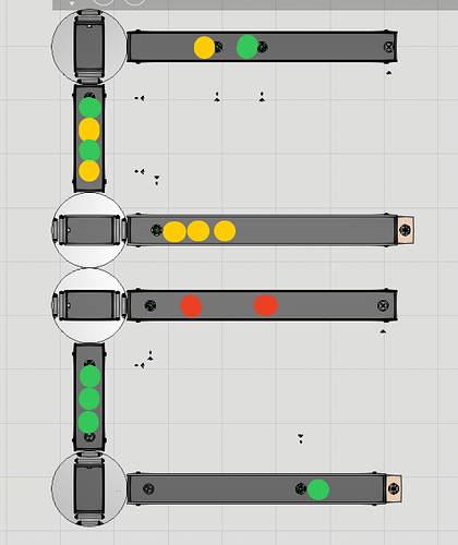

I am unable to alternate between green and yellow products one by one and enter the alternate waiting point (green is in front until they fill up to the stopper point). Do you have any good suggestions.
If possible, I would appreciate it if you could open my test case and give it a try.
