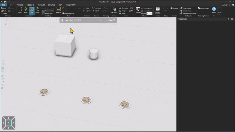

Products updater
When you modify the geometry, properties, or behaviors of a template component for a product, you need to manually clear the product’s component URI and then reassign the component. With this add-on, you can automatically update it with a single click

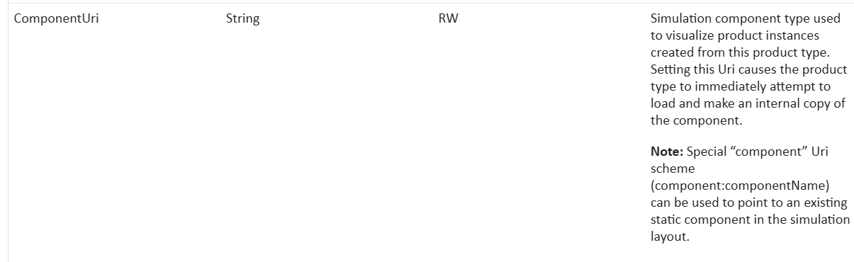

Please note that this method is only effective for product component URIs that start with ‘component:’,
UpdateProducts
Unzip to C:\Users\<User name>\Documents\Visual Components\4.10\My Commands\Python 2
UpdateProducts.zip (974 Bytes)
If you don’t even want to press a button, you can create a new component, write this script into it, and it will automatically update every time the simulation starts.

    if "component:" in product_type.ComponentUri:
      component_uri = product_type.ComponentUri
      product_type.ComponentUri = ""
      product_type.ComponentUri = component_uri
