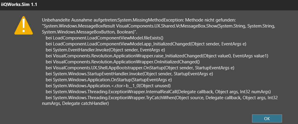

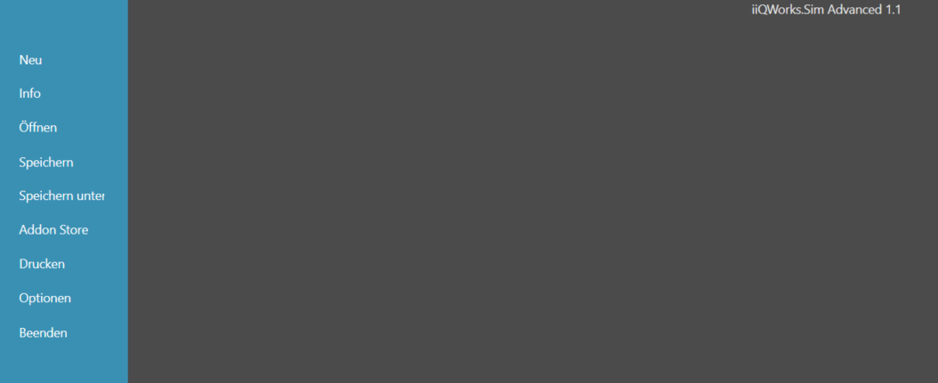

Hi all,
I tried it with the new upcoming iiQWorks.Sim 1.1, which works at least for the AddOn Store.
Unfortunately some AddOns seem to be incompatible which was to be expected.
Obviously I had to test :wink:
Now ending up with throwing errors on startup
and I can’t even get back into the uninstall section of the AddOn Store.
Is here a way to uninstall it with console or somewhot file based?
