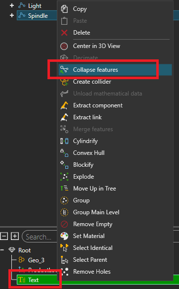

But why do they not show in blenderer?
Can that be fixed somehow?
-Micael
Collapse the text should work
Hi, if you mean collapse them in the cell graph - that didn’t help
Collapse the text feature

I’m using it in KUKA.Sim which could be the explanation?
That did the trick - thanks for your patience!

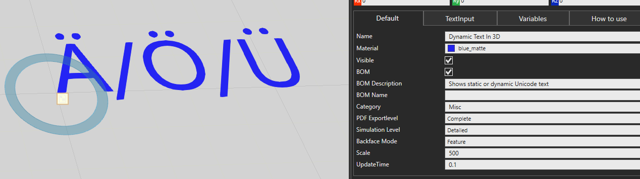

Hello, i just stumbled across your video about the multi-language suitability of VC_TEXT. Would it be able to update the component “Text in 3D” so that it also supports characters like “Ä/Ö/Ü” and other characters where the component just gives out “” when not understanding a certain character? Thanks in advance
Use “Dynamic Text In 3D” component, it supports Ä/Ö/Ü, if the message never change, set UpdateTime to 10000000
Perfect!
