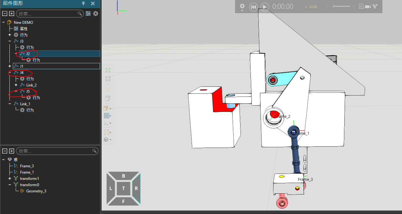

Friends, please help me check J2, J4 and J5. I seem to have encountered a problem, but I’m not sure which one is correct.
New DEMOv2.vcmx (190.0 KB)
Thanks
