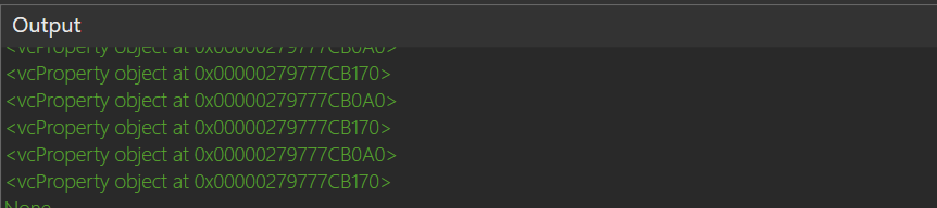

I am trying to read the home position from KUKA.sim pro 3.1. After researching the internet for more than 4 hours I can’t find the answer. After some trying I get this:
This forum is primarily for the Visual Components software. However, there are a lot of similarities with KUKA sim pro.
Using prop = comp.getProperty(‘property_name’) will get you the property object.
You can get and print the value of that property with print (prop.Value).
Setting a property value is done the same way, so prop.Value = “XYZ”.
