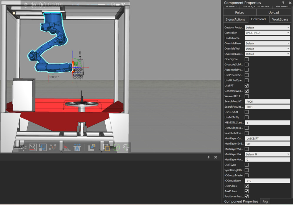

Drusilia,
Once you Download a program it will show you all the variables in the Component Properties. If you “UnCheck” the three at bottom right corner that have work Pulse, then the Post will be in a X,Y, Z (Rx,Ry, Rz) format (Rectan)
How do you Post process the program?
You can use the forum add-on or if you have OLP variant of the software, there should be “Postprocessr” button on the program tab.
