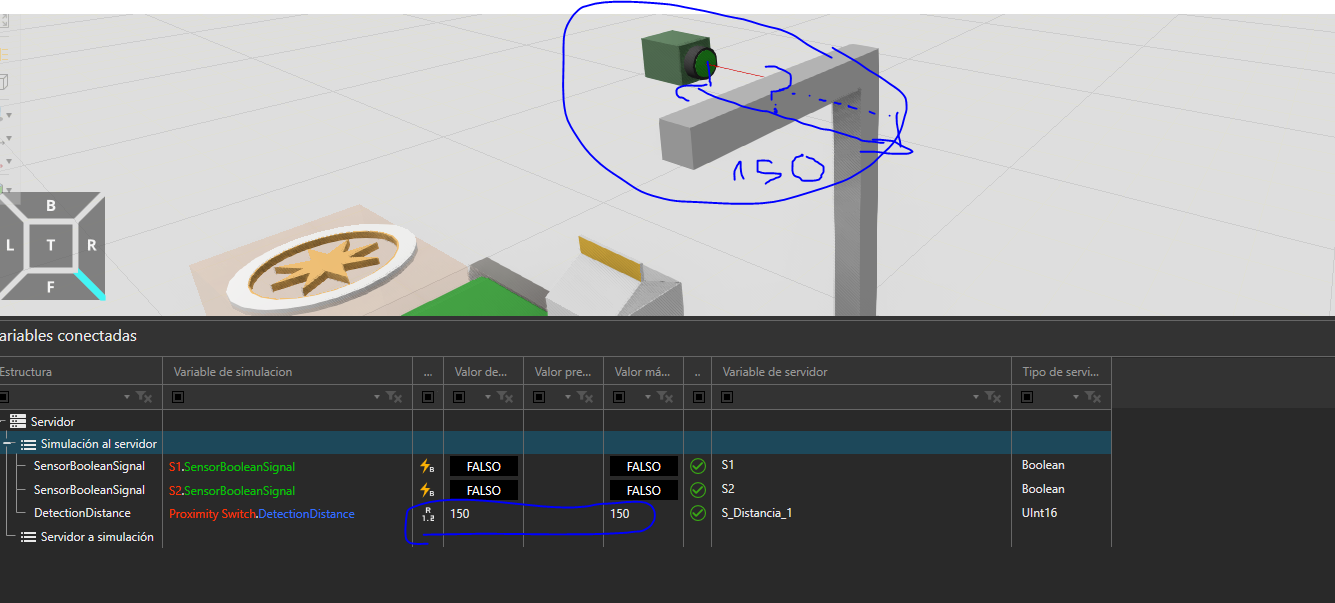

Hello, im using the distance sensor but the value does not change, it stays the same value as the one that says the maximum distance of the sensor.
Thanks in advance!
It seems that the paired value refers to a constant parameter value instead of the numeric signal that tells the measurement value.

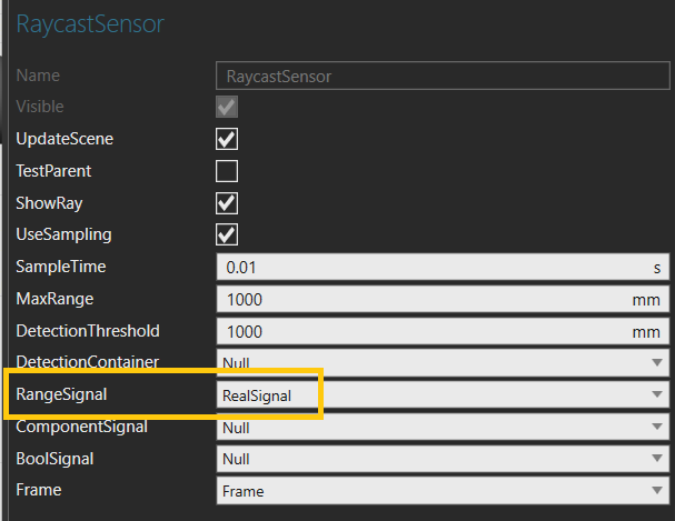

  1. Go to Modeling tab and find the Raycast Sensor behaviour of the sensor component
  2. Make sure that the RangeSignal has some Real-type signal assigned

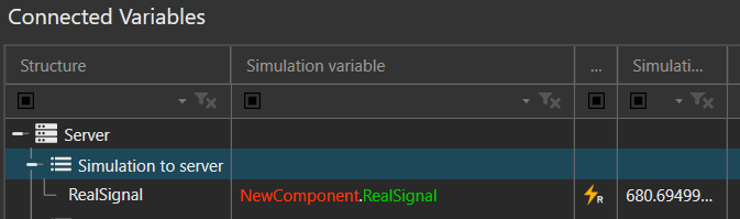

  3. Use the same real-type signal for the variable pairing. It should look like this in the Connected Variables panel:
