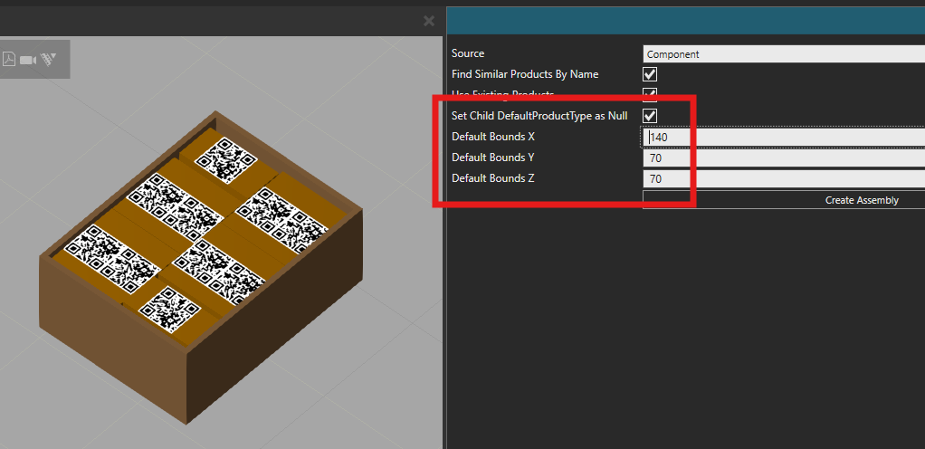

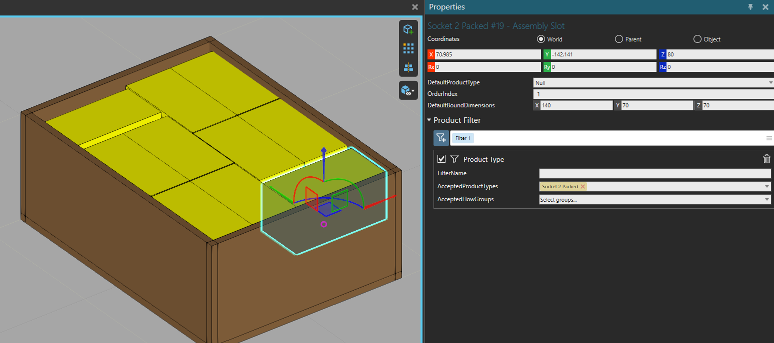

Auto Assembly is a great addon and has become a standard tool I use in VC. However in many cases in my simulations I had the need to create assemblies where some steps don’t have a default product and are instead defined by flow groups, for example.
So I actually made this modification to the plugin that you can create child steps with DefaultProductType as null and just define the boundary.

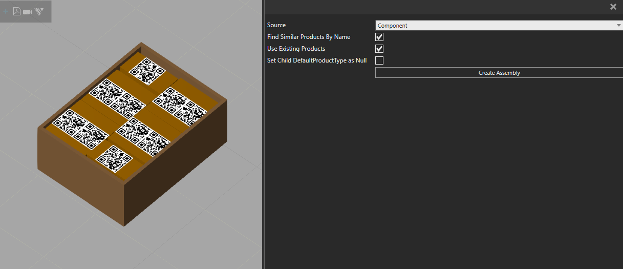

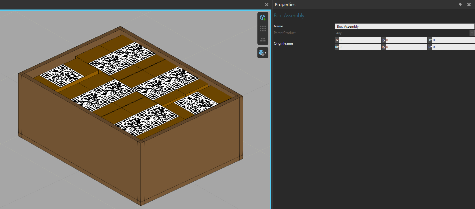

So with the regular settings you can create an assembly like this, a box with a pattern of products inside:
But if you enable the additional option, you can create an assembly like this:
This might be useful for others as well, but I’m not sure how it works with publishing modifications to existing addons. I just have it in a private github repo at this point - let me know if it might be interesting. :+1:
