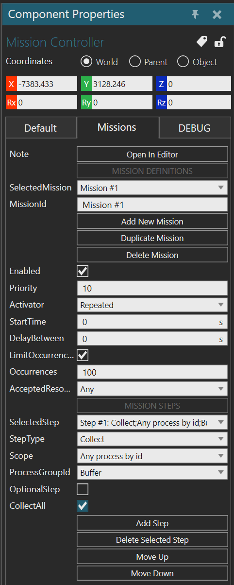

In this layout, an AMR transfers products from a shelf to 4 process nodes.
The AMR has capacity of 2.
I don’t know why the AMR picks more than its capacity at the shelf when using Mission Controller.

Try to uncheck ‘CollectAll’ in the Collect step in the mission controller
