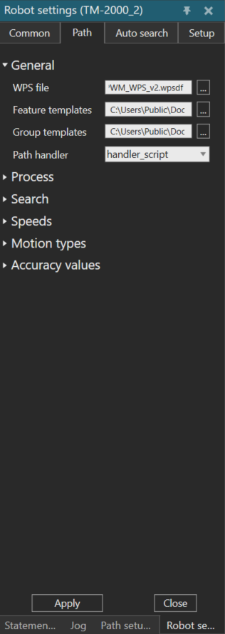

What didn’t you undestand specifically? Is it the WPS file?

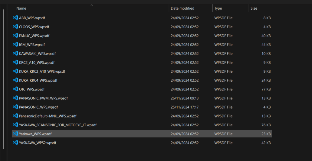

You can see some example files if you go to your robot settings and click browse in the WPS file option. There’s a folder with examples for each manufacturer.

Happy New Year! To be precise, I’m not very familiar with the template import section (XML/CSV). I’ve seen their descriptions in the help files, which are usually just one sentence, but I’m not quite sure how to obtain them (at least not when I posted this).
Fortunately, I’ve managed to export usable XML from NX. Though I’m not sure why it’s offset by 8.78 on the weld Z-axis compared to my settings in NX.
I’ll also look into the WPS files you mentioned later. Thank you so much for pointing out the example location!
