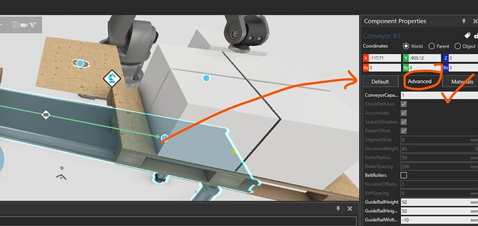

A quick solution would be to simply limit the conveyorCapacity to 1.

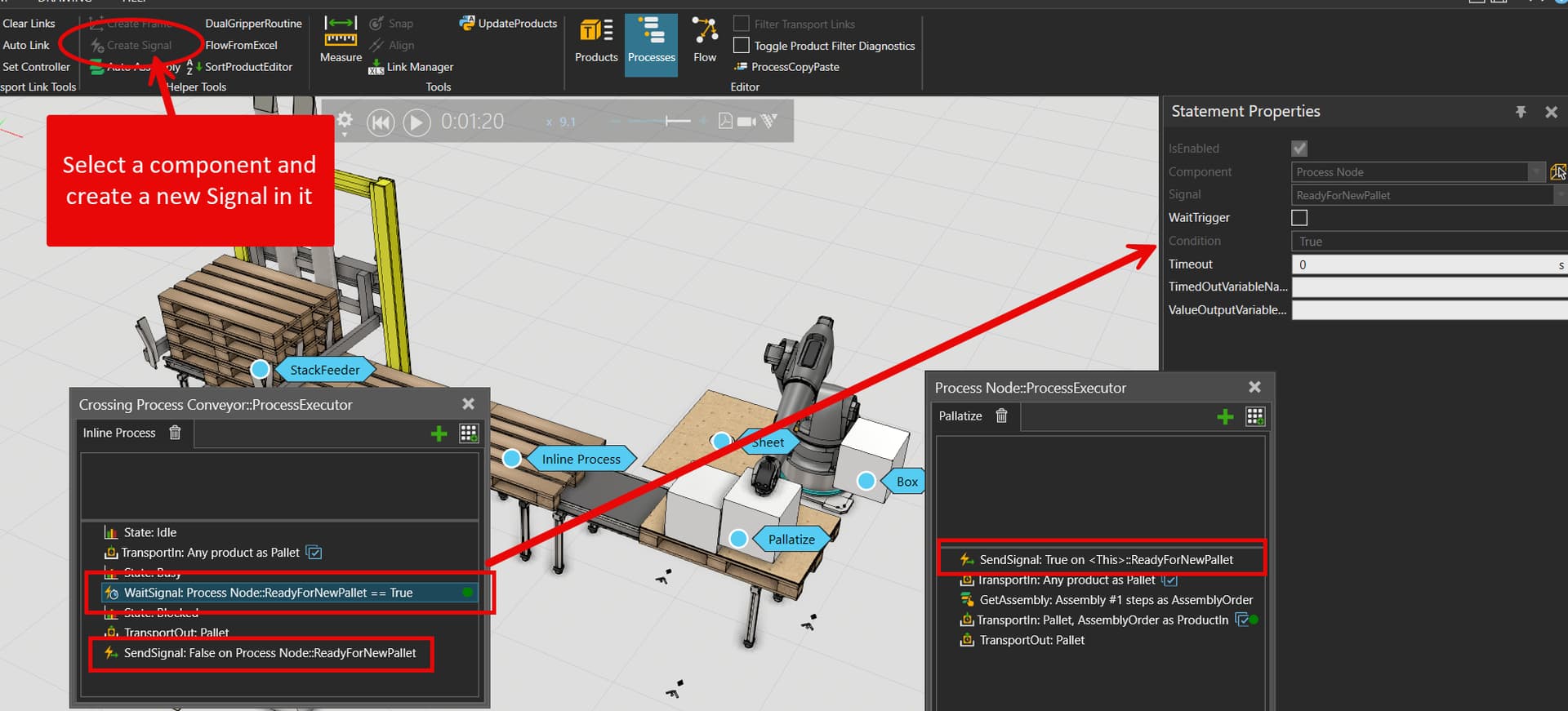

another way of doing it would be to use a signal.
  • Create a boolean signal in the palletize process
  • set it on True at the begining, to send a new pallet
  • the Inline Process signal wait for this signal to be True to send a pallet and set it on False after having sent the pallet
  • when the Palletize process is finished, it will start again and therefore set the signal on True again
