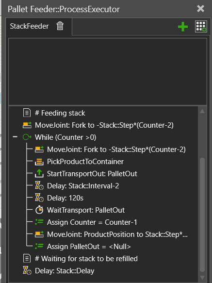

I want the Pallet Feeder to be set up to destack pallets one by one for pickup by Mobile Robots. I have modified the Pallet Feeder Process Node and connected it to the next process after removing the WaitPathContainer clear. I added a 120-second delay to wait until the next process is completed, but I’m looking for a better solution that doesn’t depend on a delay.
Wait_for_next_process.vcmx (223.3 KB)
