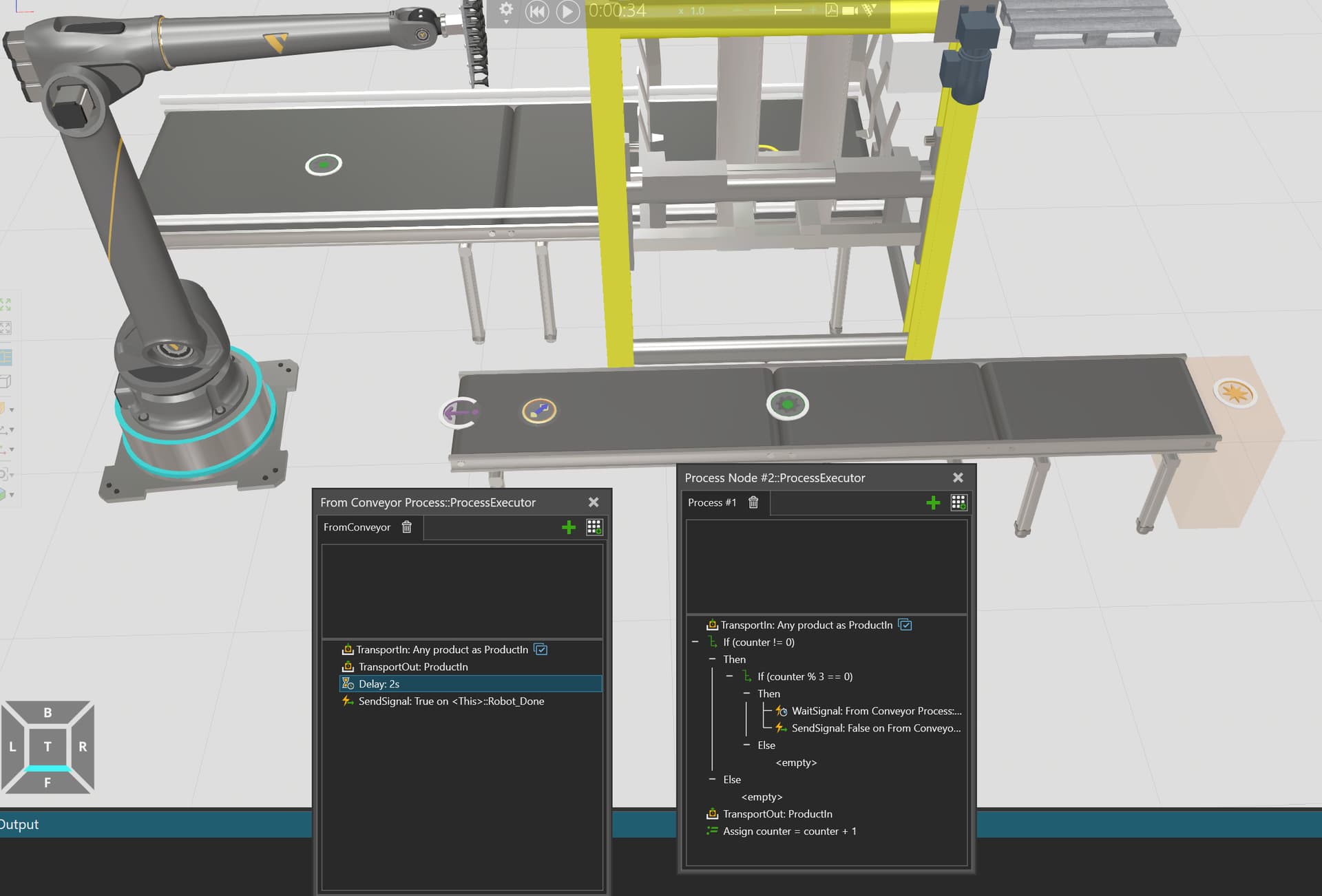

You could add a process before the last conveyor and create a boolean signal in it (for example “StopProduct_Signal”).
In the process you can let 3 products enter and exit, then set the StopProduct_Signal on True, and wait for it to be back on False.
In the FromConveyor process, when the robot takes the products, you can set the signal back on False.
I have tried, but I could not get it. @Tilma Could you please show a picture as an example?
You could try this for example using an extra node and a signal:

@Jesper Thank you, Now its working
