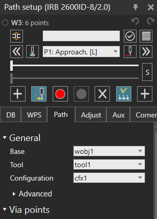

Visual components attach welding paths to a CAD model

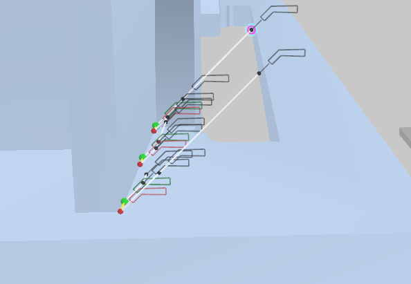

visual componetns has attached my welding paths to a workpieces not to the workobject,
when I move the workpieces it moves with it, although the base (work object abb) still in the same places.
for me I don’t have any workpieces positionner so I prefer my paths stay attached only to the base ?
how can I solve this problem
I think if you change the Workobject’s node from World to the part, it should work as you want.
