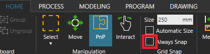

Please check that you have “Always snap” option set to False on Home/Process tab.
