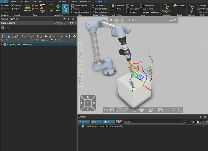

I’m using Visual Components OLP to generate welding paths for a DUCO robot and exporting via a JSON post-processor. The JSON file is generated, but the point table comes out completely empty — no weld positions are written. Please see the attached image and layout file for reference.
Has anyone encountered this with DUCO post-processors in VC? Any help would be appreciated. Thanks!

Did you check the post processor in C:\Program Files\Visual Components\Visual Components Professional OLP 5.1\Python 2\Commands\Olp\OlpTranslators\JSON?
It seems that it does not translate weld paths, only standard PTP and LIN points.
