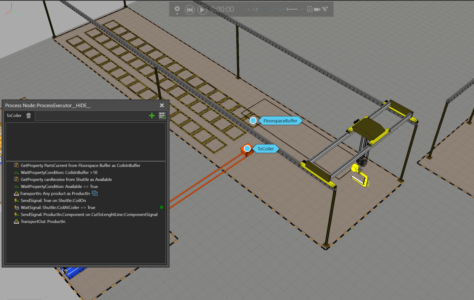

How can I set up a buffer so that it only refills (from another buffer) when it has X amount of parts remaining?
Use WaitPropertyCondition before TransportIn.
Hello @juhahai
Thank you for your answer, could you provide me with an example?
I’m unable to achive the outcome that I want…
The crane transfers coils to the shuttle only, when the property condition is met. In this case the property is from the Statistics. You can use your own properties as well, and then you don’t have think about the interval of Statistics.
