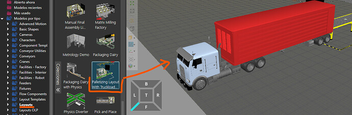

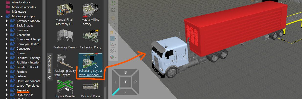

There at least were a couple of demo palletizing layouts with a decent looking truck & trailer.
Open the Layout “Palletizing Layout With Truckload Forming”
From there you have 2 options:
1 - If you are using Professional or Premium, you can save it as a new component.
2 - If you are using Essentials, delete all the other componentes (and Process Modelling Logic) and start you model there.
Thanks for the reply. I’m using Essentials, for now, so I’ll try approach number 2. Hadn’t considered that, but I think that should work!
That sounds like a good strategy. I’m going to try the approach another person suggested of using one of the existing layouts that has a truck and clearing everything, then starting from that file. I’ll keep this in mind for the future, or if I hit any roadblocks with the first plan.
