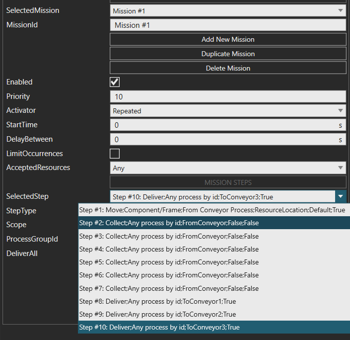

  • Another possibility would be to just use a Mission Controller and repeat the “Collect” step with “CollectAll” deactivated, until you have all products, then go deliver them. You can Copy Paste the “Collect” steps in the Editor to make it quicker:
