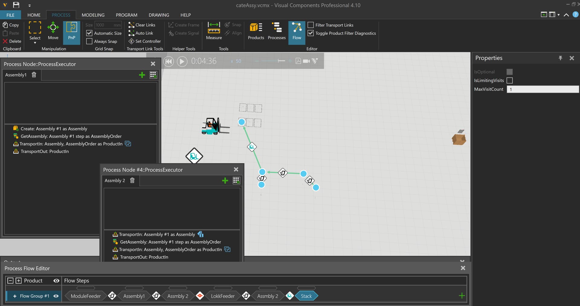

Hei, can anyone help me, im struggeling to transport the final full assembly from The Assembly2 Process to the Floorspace stack using the Forklift Truck. I’ve attached a link to the layout.
cateAssy.vcmx (3.0 MB)

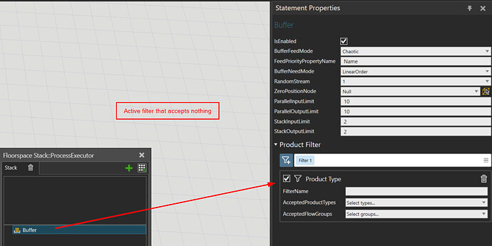

Two problems I noticed.
  1. All products are in one flow group, which makes it hard to follow. It’s usually better to have separate flows so that the sequences are easy to follow.
  2. The Buffer had a product type filter that accepts no products. This prevents any products from entering.
Updated layout:
