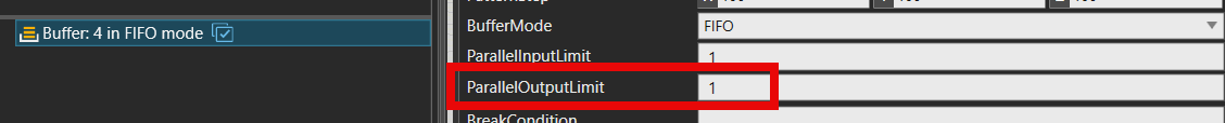

yes, and for them to be delivered all at once from the Buffer, don’t forget to set the “ParallelOutputLimit” higher. It will define how many products can be transported out of the process at the same time
Thanks, guys. I solved the problem by adding a delay to the upstream process node to control the buffer’s storage time, along with a few other process modelling tricks.
