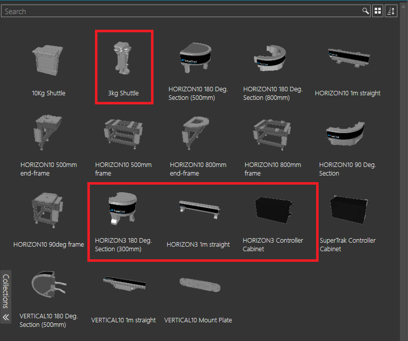

Hello. Components of Supertrak CONVEYANCE Horizon3 shuttle system are now published in 4.10 eCat, under collection Advanced Motion.

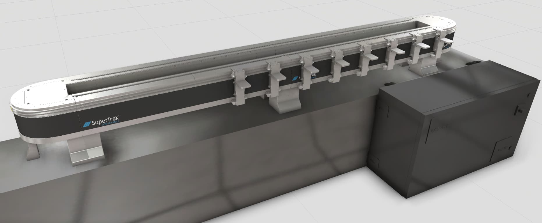

This system can be operated in simulation mode (default), meaning that the shuttles are treated as products on a closed-loop conveyor. Use Advanced Motion > Visual Components > Track Process Node to define processes along the shuttle line.
Alternatively, the system can be operated in external controller mode by connecting property “ActPos” of each shuttle to a server. This way, the conveyor logic is not used and the shuttles can be controlled individually.
Feel free to use the attached layout as a reference when using these components.
