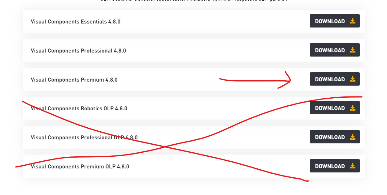

The installer is complaining about the OLP variant. We currently have 3 different versions and each version has an OLP variant to it (so 6 different installers). You only need to download the Premium version (as stated by your post, you downloaded both) and run only the premium one.
If you downloaded the marked version and it didn’t work, please contact support@visualcomponents.com and send them the license key you received. Alternatively you can whisper/send the five first letters of your license key to me/here (don’t send the full license key ). These five first letters determine the version and the type of the key you received. In your case the five first letters should be VCP48
