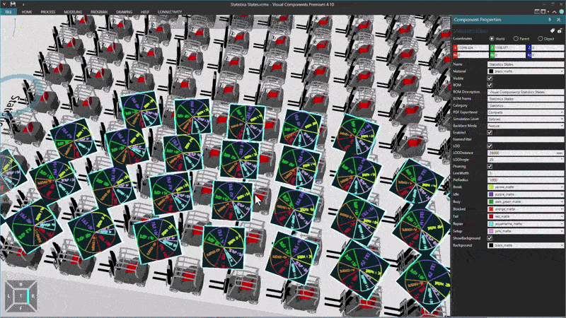

Pushed to 4.10 eCat, display the Statistics States of entire layout
Key properties
- NamesFilter: Activate when non-empty, check if component name contains the keyword, using a comma as the delimiter
- LOD: Level of details
- LODDistance: Ignore component when component is farther from camera than LOD distance
- LODAngle: Ignore component if the angle between the (component - camera eye) vector and the (camera coi - camera eye) vector exceeds the LOD angle

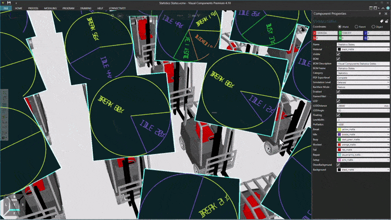

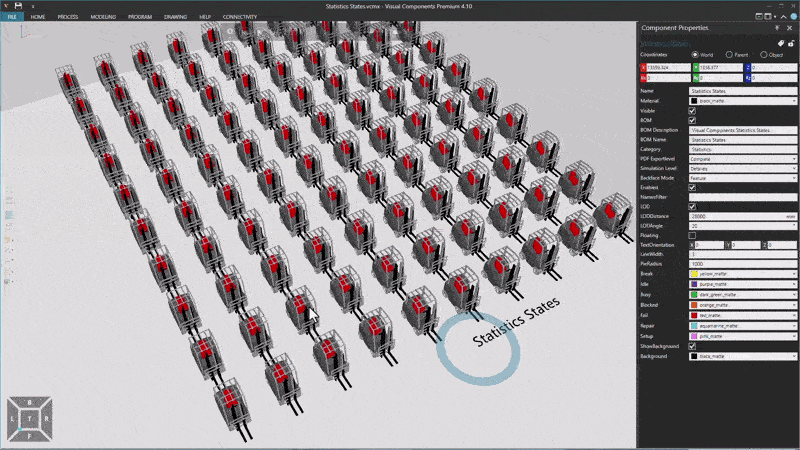

- Floating: Always facing to camera
- TextOrientation: When Floatingis unchecked, the orientation of states is set to TextOrientation
