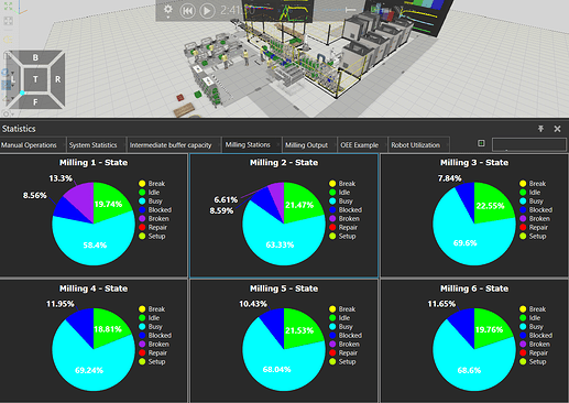

There are no Stacked bar charts in VC. The best you could do is show the State as a Pie Chart.
You can also export the statistic data as Excel or CSV and create your bar chart there.
