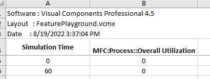

Further, I would like to export statistics to excel but change the template. Any idea where I can find the addon?
