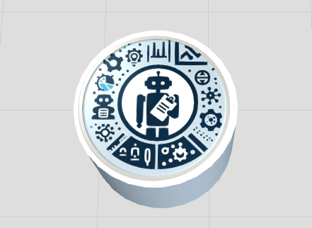

New statistic builder component published to 4.10 eCat.
What can be done with this component?
-Automatically create component groups by loading component into an existing layout.
-Quickly create statistics dashboards based for these groups
-Create custom expressions using group properties and component properties.
