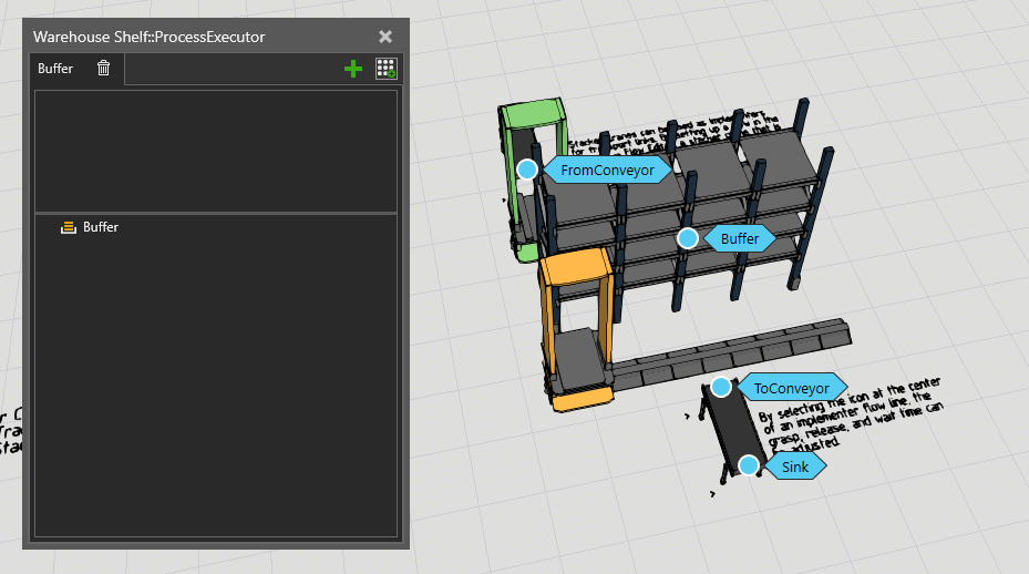

I’m a newbie, I use Visual Components for my Thesis work but I have an issue :frowning:
I just want to reach the statement properties to setting the product time on shelfs. At first try I was able to reach it by clicking on the process name “buffer” and clicking again on “Buffer” in the popup window, but now the statement properties do not appear if I try to open it and I dont know why. I checked some video, based on the videos I do it correctly. Maybe my license/program has a bug? (I tried to open a fully new project but same.)
You might have accidentally closed the Properties panel from the right. Click Restore Windows button from the upper right to restore the default panels layout.
