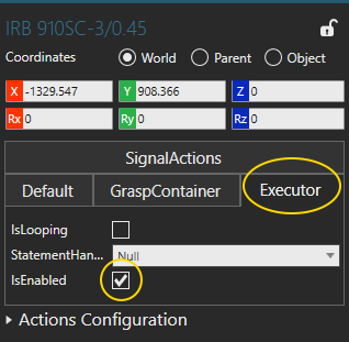

Please make sure that the robot program is executed by enabling the executor in the robot component properties:
P.S This seemed to be disabled by default when taking the robot out from eCat.
Thanks jouha! It’s the reason. This default value of this robot is really different from others.
