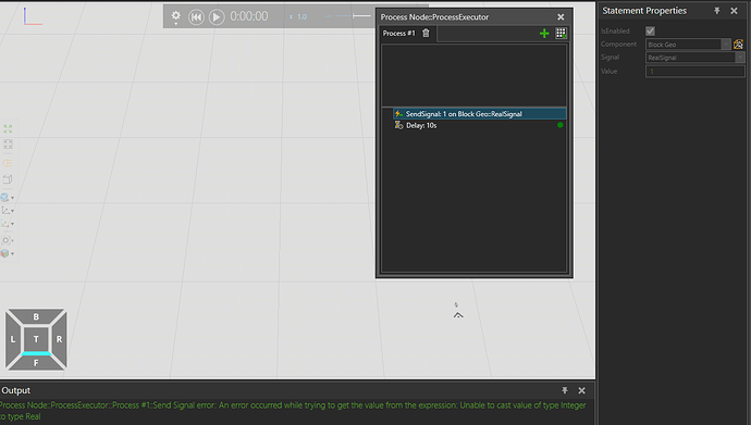

If I make a real signal and try to send 1 it gives the same error:
But if I input 1.0 it works:
(using VC4.10)
