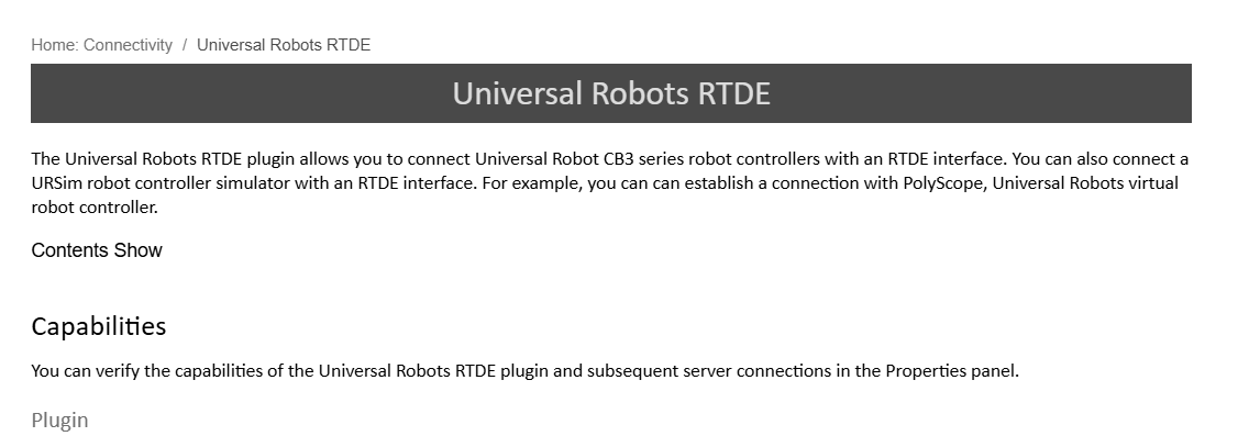

Visual components RTDE documentation says VC can connect with CB3 universal robot series. Can it also connect to e-series of UR, ? Can we control the UR robot from Visual components? Any experience or help in this topic is appreciated.

Any UR robot that supports the RTDE interface should be supported. As I’ve understood, all e-series models should be supported.
