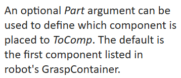

After the above observation, and combined with the VC help file explanation, we can learn that the general flow of this problem is like this: when the robot grabs the first component, it reaches the first tray component and tries to place it down, and this piece of code I expect to use try, so the program should still want to do the handover of the subcomponents after running the attach instruction, but the tray component doesn’t have a ComponentContainer, so the program tuned past the release resource operation further down the line, which means that after the first operation, in the robot’s grab table, there is still the first square component (which normally should be deleted), so everything that follows can be explained, because the later grabs, in the robot’s grab table, will be Pick_table[ 1], [2]. So none of them can be put down properly and the parent of the first part component will keep changing,And because try exists, no error is reported, or the backend has handled it automatically.

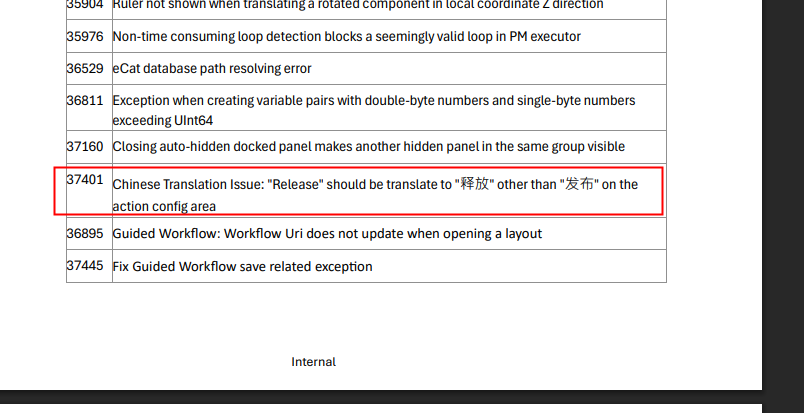

I think this issue may not have been flagged as a priority, in fact, yes, because he could have circumvented it through conditions.
Also, I’m not quite sure what you meant when you posted about the changelog in VC4.10.2, isn’t this paragraph about translation issues?
