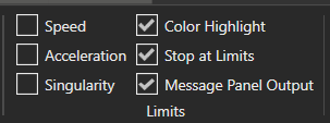

It sometimes happen that my robot executes a PTP/LIN motion and I can see one of joints turning red in the Jog menu, indicating it went beyond it’s min/max value. Why does this happen?

I found about the Limits gallery (from the PROGRAM tab), which takes care of joint limits. If you check the Stop at Limits box, the robot won’t go beyond its joint limits.
