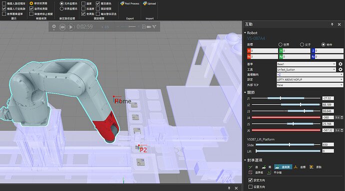

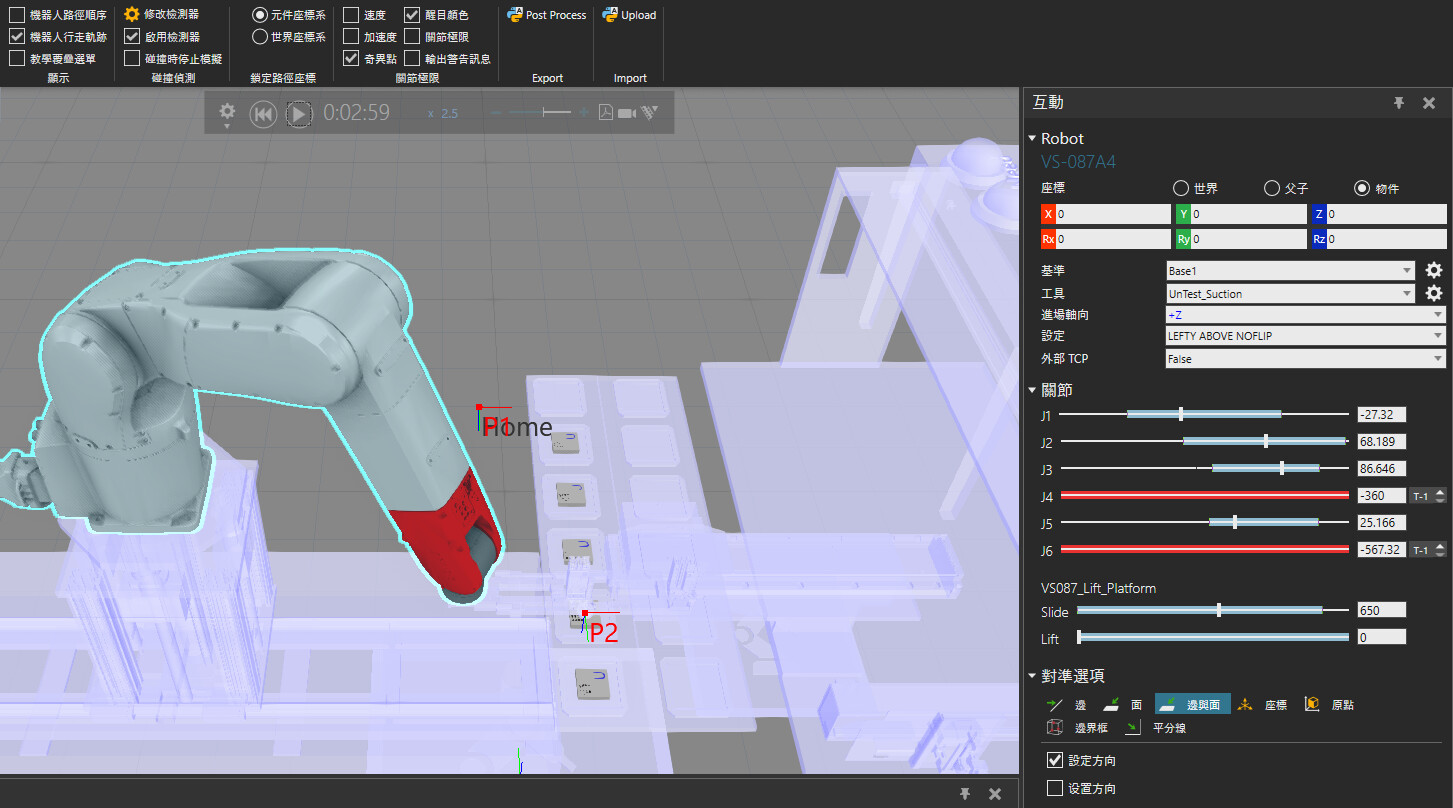

Hi Forum,
I’m using an RTC to control a robot for pick-and-place tasks.
However, sometimes the robot’s J4 axis rotates from 0° to -360° before reaching the target position, as shown in the images below.:
Does anyone know how to set strict joint constraints to avoid this fancy action?

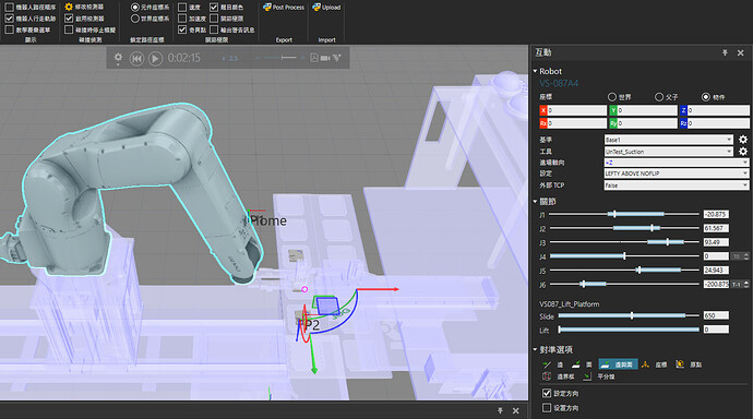

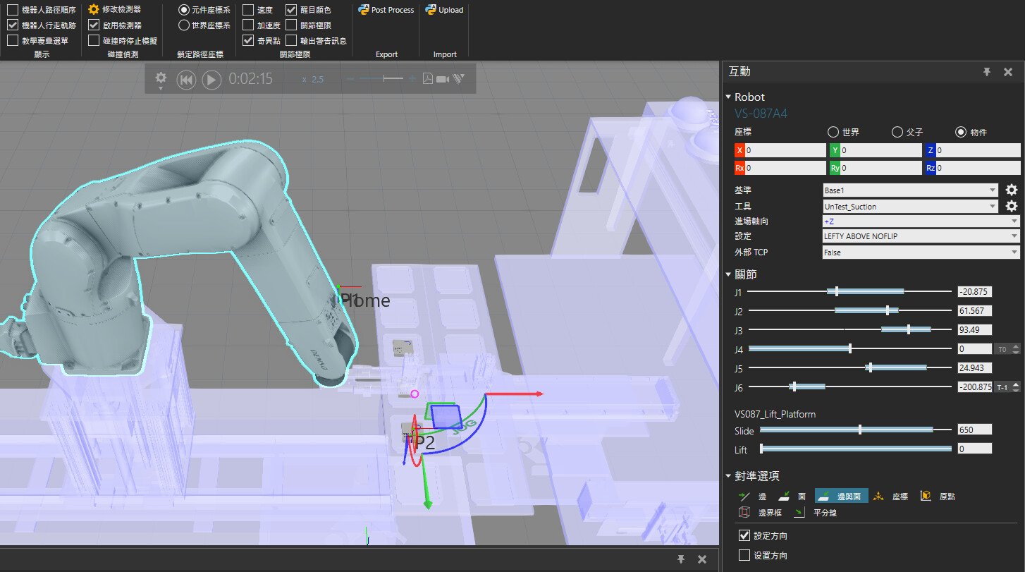

Click on the small arrows next to the axis sliders to set the axis turn counts, and then touch up the point.
This doesn’t help because those points are created by the RTC (vcHelpers.Robot2).
The same issue will occur again when a new taught point is created. :smiling_face_with_tear:
