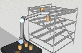

Hi everyone,
I’m experiencing an issue with collision avoidance in my simulation and hoping someone can point me in the right direction.
Setup:
  • I have a process where a robot delivers parts to a sink
  • The sink is placed inside a FIFO rack (standard component from the eCatalog)
  • When the robot places the part onto the sink, the arm passes directly through the FIFO rack structure
What I’ve tried:
  • Used excludeObstacle command via the robot controller → no effect
  • Used PrecisionObstacle command via the robot controller → no effect
The robot still ignores the rack geometry and moves straight through it.
Any help or suggestions would be greatly appreciated!
