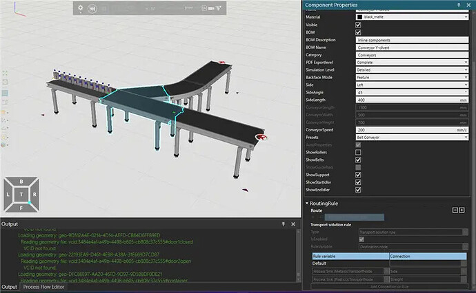

Quick question: Is it possible to use a divert converyor Transport solution Rule in combination with the “Component Container” functionality?
While using the layout from the academy and changing the sources and destination to component container this is the result. (with cyclic rule it does work)
4.2 - Route Products using Transport Solution.vcmx (415.1 KB)
No, if you TransportOut to a container the system does not find and assign any destination process to the product and thus there is no transport solution either. That basically doesn’t use the PM transport system nor the PM product need and feed matching at all.
You could create a transport solution using a python script and assign it to the product instance, but still there won’t be any process waiting for the product.
Thanks for the answer, now I understand the reasoning why it is not working.
