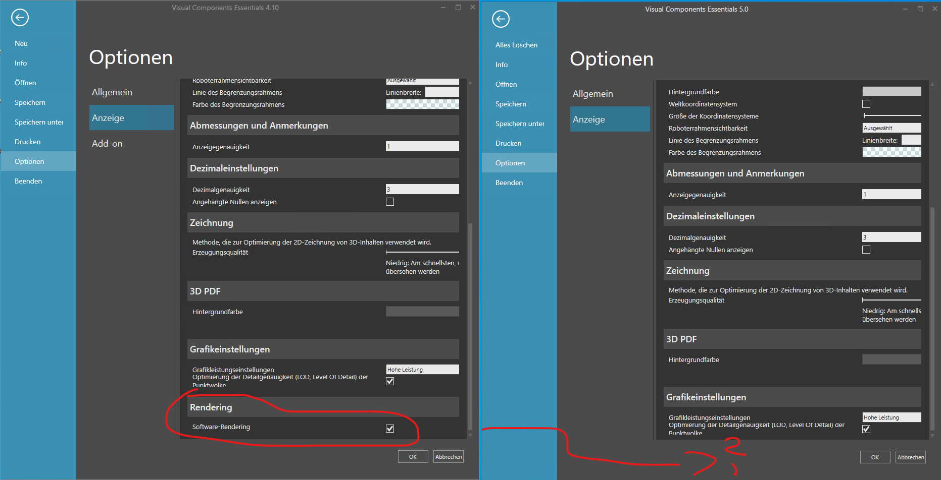

Howdy. Are you using VC 4.5 with a network/floating license? If so, go to File > Options > Display and look for “Software Rendering”. You can also find it in the app config file in your app data by searching for “softwareFallbackMode” and set it to true. If enabled, everything should work fine. Note that you need VC 4.5 or higher for this.

Hy @WilliamSmith,
but where is the option in VC 5.0?
Thx & Regards
I’d really like to know where this feature has been moved.
I often need to use Remote Desktop to discuss models during meetings.
Hy,
download current version of VC (5.0.1) and the checkbox is back! :wink:
