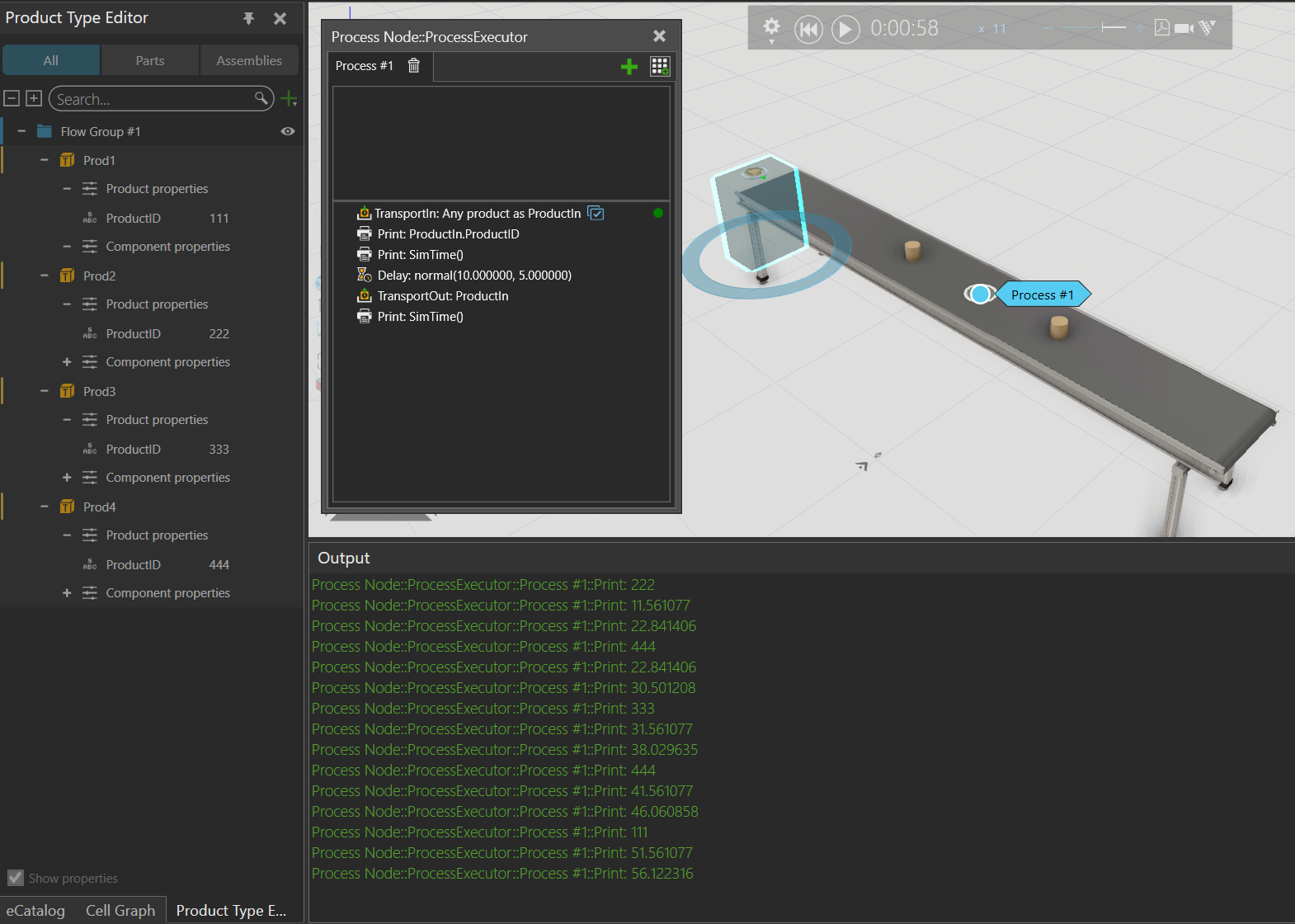

You can do it directly in the Process, without writing a PythonScript:
→ if the ProductID is a Product propety, you can use the notation "ProductIn.ProductID", if it’s a Component property you can use the notation “ProductIn.Component.ProductID” (Process Statements)
→ you can use the Expression “SimTime()” to get the current simulation time
