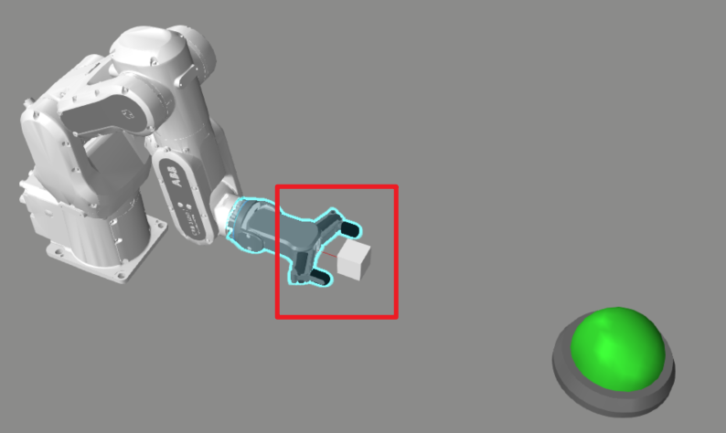

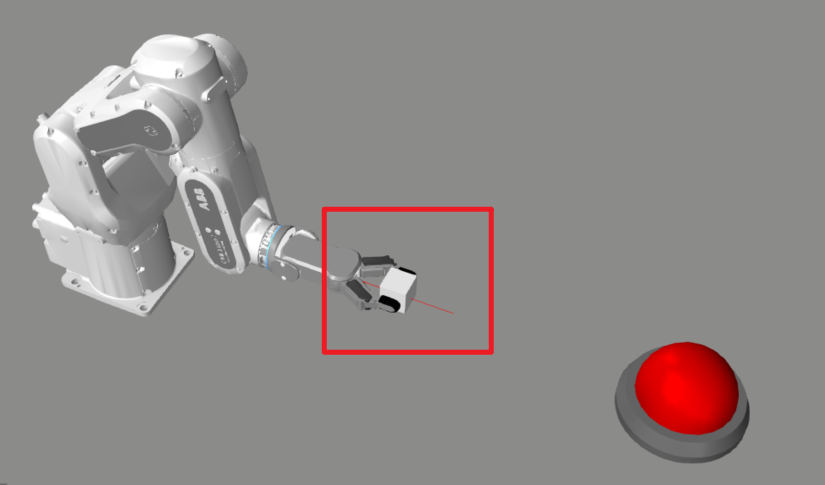

There is a RaycastSensor on the robot’s gripper. When a component is detected, it will be triggered. However, when the robot picks up the component, the RaycastSensor will not be triggered. I think it’s because the container of the component has changed. Is there a way to keep triggering when a component is detected?

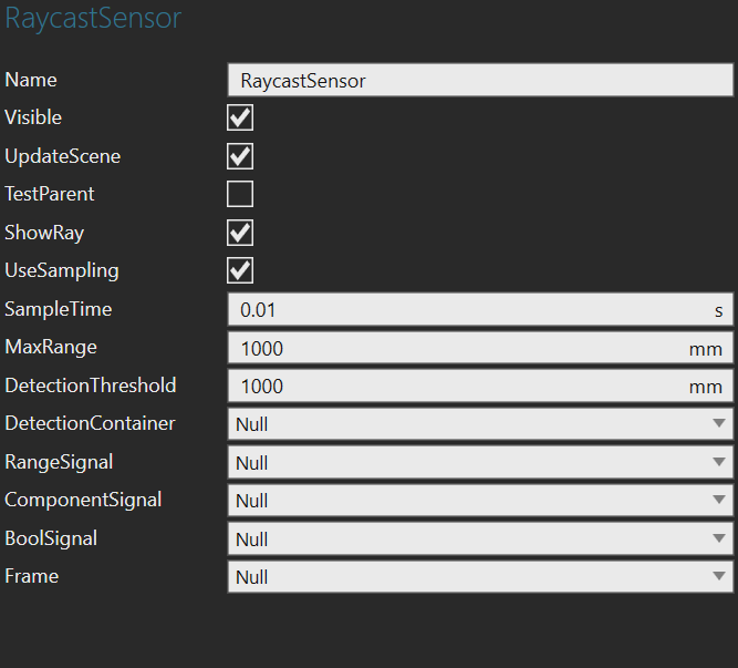

Yes, this is because the cube component is grabbed by the graber container, and the parent component of the cube changes from application to graber, which can happen if your ray sensor doesn’t tick TestParent, you just need to check it.
