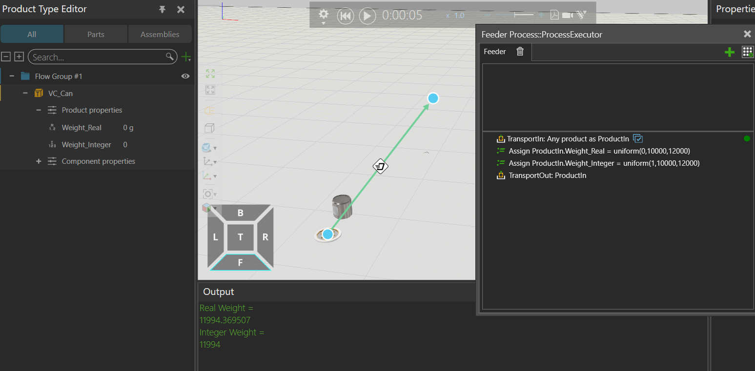

I need some help. I’m creating a parameter called Weight in a Product, which should randomly generate the product’s weight in the range of 10,000–12,000 grams.
I can’t figure out how to correctly use the random number generation function for Integer and Real types.

  • If you created a Product Property, you will be able to get it from the Process with <VariableName>.<PropertyName>, so in your case it would probably be: ProductIn.Weight
  • If you created a Component Property, you will be able to get it from the Process with<VariableName>.Component.<PropertyName>, so in your case it would be ProductIn.Component.Weight for example.
To assign a weight to the products, you need to do it in a process, for example in a Feeder process after the Product was created with an “Assign” statement.
If you want a uniform distribution (–> in range a <= x < b) the you can write it uniform(stream, a, b), so in your example it would be uniform(0,10000,12000) . You can write this function it the same way for a Real or Integer property.
You can find this informations in the Help file under “Expressions” - “Functions” and “Expressions” - “Process Statement Expressions”.
I think you should be able to simply create Real type product property in the Product Type editor and assign a distribution to it. Each product will then get a static sampled value from the distribution.
Distributions aren’t supported for integer properties, though.
That’s works!
Thank to both of you!
