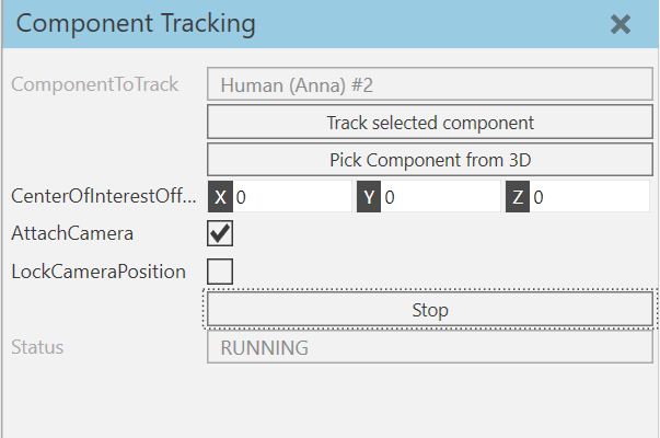

Is that possible to make video as a human viewer? when we use view editor, it could change different viewer to finish the video. But the view is not real as human view.
I try the " ComponentTracking_Add-on", that is not the result I want to get. Is that possible to do this?
Thank you in advance.
You can use the Component Tracking addon and attach the camera to a large gantry robot that moves the camera where you want.
It’s quite fun from Annas POV, but she moves a bit to much for it to be very fluid.
Attaching the camera to a robot would be better!
How to change the view to Anna? When attached camera to anna, the camera just moved the observation view.
Changing the CenterOfInterestOffset doesn’t work.
Thank you very much.
Check the property “LockCameraPosition”, you will also be able to set the CameraEyeOffset.
Yes, it is, but the ComponentToTrack is always in the center of the view, even the cameraeyeoffset is changed.
I tried different components to modify, but it can’t be like the view you uploaded. ![]()
