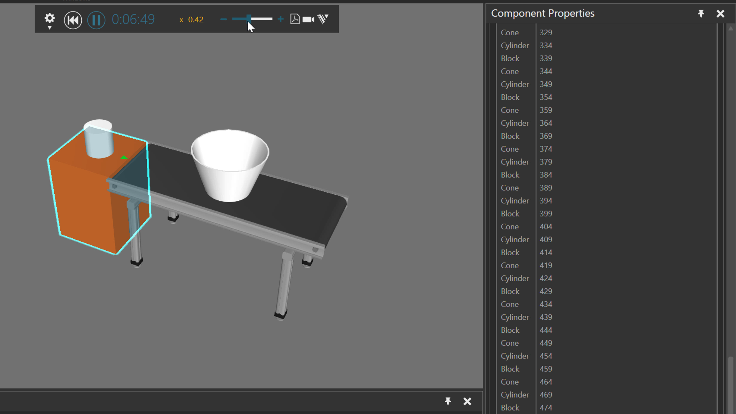

There are many ways to create components. When there are not many components, you can use the PROCESS module to quickly perform operations, or you can use ready-made feeder class components to create them.
If you are learning how to create such a component, you can refer to the materials in the Academy:
If you are learning how to use Python scripts to create such a component, you can refer to functions such as Clone() and CloneComponent() in the manual.
