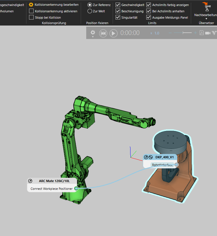

the bug still exists in VC 4.10.2 :sleepy_face:, steps to reproduce are quite simply:
  1. Build a layout with standard components from eCat
  2. Connect them via interface
  3. Set all limit checkboxes in program tab
  4. Do a PTP-motion statement and move the external axe and baammm
May you find out whats the problem here??
