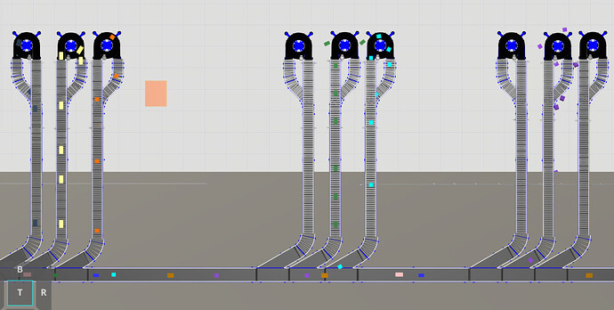

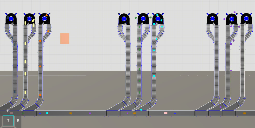

I have a layout with a sorter to a number of down spirals (see image). Some of the products do not ride on the spiral, but instead jump out into the air. In the past, I would make the spiral the next size larger, run the sim, stop the sim, change it back to the size I want and it would correct itself.
In the image below, that routine worked for a few of them that are current correct. I have two (purple and dark green boxes) that will not update. I have tried a reboot and saves, but nothing changes the state. I moved the box to a different spiral and the problem moves with it.

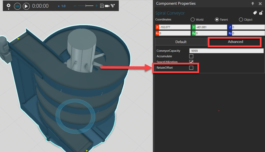

Could you try deactivating the property “RetainOffset” of your spiral conveyors?
I was working on cleaning up the file so I could share it, but this worked (retain offset). Thanks very much for the help!
