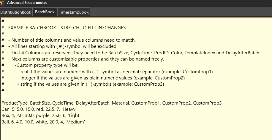

To add to Tilma’s reply, the component “Advanced Feeder” in 4.10 eCatalog has something very similar. It creates the components on the right order and gives each created component the right properties that were read from the table.
The component comes with an example of each feed mode that you can open by clicking the note. I’d recommend CreationMode Batch or Timestamp, you just have to add the intervals/creation times manually to the spreadsheet.
