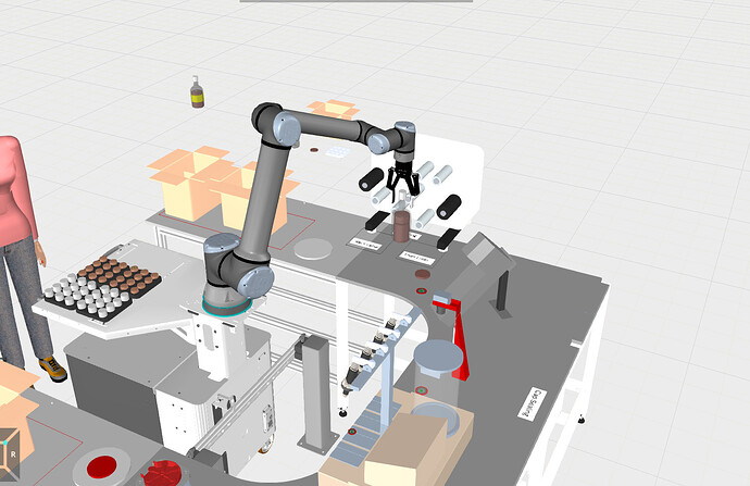

Hey guys,
Any help on this would be greatly appreciated. I am trying to create a process layout with an idea to modify the pick up and place routine later on.
At the moment I am able to complete the cycle of picking up a bottle and filling it up and placing it in a box. However I am unable to get the robot to keep on repeating the cycle.
Any help on this would be greatly appreciated. I have attached the file for reference

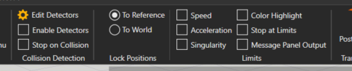

The new file is also working for me. Do you have any of these checked? Maybe it is stopping because of a collision or a limit:
Oh yeah? Working as in, it repeats the cycle?
I do have singularity checked in. Does that matter?
yes, it waits for the Delay in “Fill Station” to be over, then picks another bottle and repeat the whole cycle. → with the Delay of 1000s you have to wait a bit more than 16 minutes…
I just tried with the singularity checked, but it still worked. With which version are you working?

Hey Tilma,
I had a quick question around Robot programming combined with PM.
I am having a glitch with the pick
  1. Pick from Top - Whenever I try to pick the bottle from the top - it does not lift all the components attached to it.
  2. Also the Gripper Position - I want it to hold the bottle by the neck.
    I tried manipulating the J Open and Close value for the gripper - but it does not work as it only takes either of one. i.e. If i hold the bottle from the side or the neck.
Any guidance on this would be really appreciated :slight_smile: Thank you again
