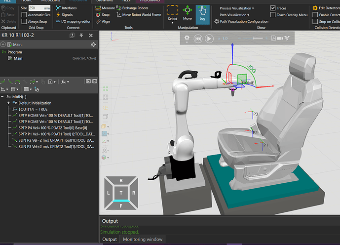

Im trying to setup a trayectory with a robot but when i hit the play button, the robot doesnt move. Does anybody know what could be the problem.
In the output section i only got the message simulation stopped and nothing happens

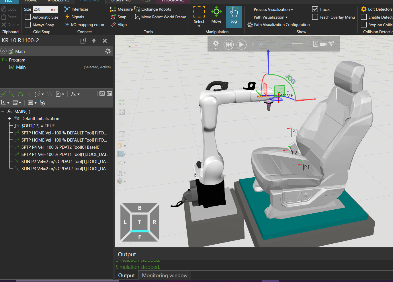

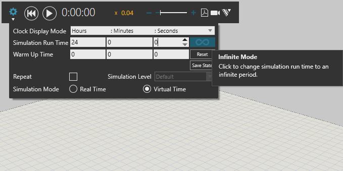

You may have accidentally zeroed the Simulation Run Time setting, which then yields that message when the 0-second long simulation has ended. Set it to infinite or to a non-zero time.
You are a life saver!
