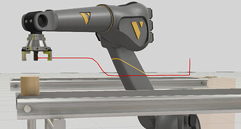

if it has to do with the collision between the part and the gripper while retracting after the placing, you could use the methods followNode to keep following the part while the gripper is opening and linearMoveToMtx_ExternalBase while retracting the robot.
I don’t know it it’s a recommended approach or best practice, but it seems to work.
In the video I activated the collision detection and don’t get any:
same code with a higher conveyor speed:
