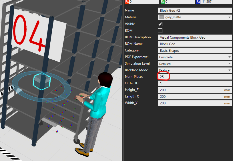

Is there a way to assign the “Pick Time” in the Flow Process Transition to get the time from an expression instead of a fixed value? Currently I can only assign a unique value in a single flow properties using custom parameters. Otherwise it will use the “default” value in the resource controller.
Pick Time Screenshot
VC Pick time
I want to model a picking operation where the human resource stay working in front of a rack based on an expression, specifically related to a property of the item to be picked.
e.g. If the human resource is going to pick from a case in a rack, the human resource will pick 1 piece faster than 10 pieces, like 50 seconds instead of 5 seconds.
Case Rack Screenshot
One thing to know is that, because I am simulating a warehouse, it is much convenient to use a Buffer process to simulate the positions of the rack, but I can not implement any expressions because of this.

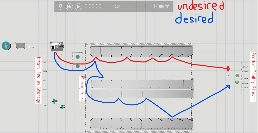

Is there a way to control how the items are received in the racks(buffer statement)?
Currently the picking locations are only being transported into a single rack alternating between them. I would like for all the buffers to act like one ( One big buffer where the Transport in statement is chaotic so that the locations to visit are random in all racks)
Picking using several racks
I have attached a simple layout with my process in mind.
